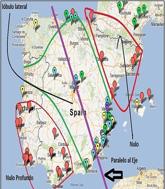

Have a look at the map in my sig, Its a few years old now but it should give you an idea, although please be aware that with the Astra 2 UK beams in fringe areas, signal strengths can vary greatly over a few km.
Probably 1.5 - 1.8m is required although Spain is in a bit of a dead zone so there are no guarantees

Galicia is a long way from where you are - and I already noted with UK beam reception in the fringes the signal strengths vary wildly over a few km.
Dont waste your money trying to get the 80cm aligned better. You wont get anything useful off it. Just buy a big dish.
a very interesting map,never seen before!
So in Carcassonne i am 50ks "in" and Tarbes would be "out"
Don't rely on those maps too much, also, is not known the dish size used for those reports.
Based on that, I should get little to no signal over here.
Even the Analoguesat's one does not quite reflect the reality.
Inside that 'null' area in Portugal I was able to get UK spot with dish size of 1.6m (so not that big), but without enough margin for rain, also tricky because you're aiming at Astra2E , Astra 2F/2G or somewhere in between, so if dish not big enough, you lose one to have best possible signal in another.
Checking locally with a carefully aligned and decent dish size is the best option.
im in the red zone below in the map near to the red line and with 2.4m its impossible to get here in the south at least the map is real,
What its the porpuse of this leakage on this sat? maybe is for the british in that zone I rememeber when was reachable here in the south i though that should be due to Gibraltar. Now they havent options.

Hi there. I live in Vielha which is in the center of the red zone on the map re this post.
Have you managed to resolve your problem and get BBC on freesat?
