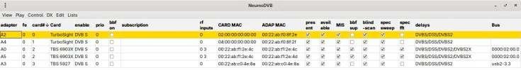

Yes satesco. I installed neumo-drivers in a new OS (cachyOS archlinux), but there's a problem - only two adapters, TBS6903x and TBS6983 were found. Missing are two others, TBS5927 and TBS6220.
lib/firmware has my cards and the 5927 in situ.
CachyOS rolling release kernel 6.12.68-2-cachyos-lts
Perhaps @deeptho could check the log ? I can only find the adapters there for the two I have
Edit:- replaced debug file after TBS5927 added.

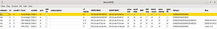

It helps to be sure that the USB plug is firmly in place in the 5927...
Just the TBS6220 T/T2/C card to find now.

LLew,
your log file does not have 5927, so it is probably the wrong one.
Your other card tbs6220 is probably an USB card and so I would at least expect to see something in the log files.
Is it visible with "lsusb"?

I thought I'd updated the debug file with the found TBS5927. I'll re-post with that hopefully included.
My TBS6220 is a PCIe tuner. I am currently using it in Ubuntu for viewing terrestrial TV from my local transmitter. Ubuntu isn't using neumo-drivers. Yet.
Confirming that the debug file isn't showing the TBS5927 in CachyOS . My other tuners are present (TBS 6983, 6903x and 6220). Although the 5927 is absent there, it works fine in neumodvb (spectrum, channel listing etc). Of course, as it's an ArchLinux OS, there's no live channel viewing, only 'live' transport streaming in the neumo folder.
The debug in Ubuntu has all the tuners showing, including the 5927.
The TBS6220, although in the debug file, doesn't scan in any T/T2 muxes in CachyOS with the neumo-driver installed.
No TBS5927 in lsusb.

These drivers were removed by tbs as the cards are very old. I have tried to re-add them. So try the newest version.
PS. I must insist that you run "bug_report.sh" when reporting errors. It is a small thing to do and saves me a lot

Despite now having all adapters present after reinstalling the updated neumo_drivers (thanks), TBS6220 is absent in neumodvb frontends, so nothing to see if I scan any T/T2 muxes.
bug_report has what I assume is the generic fw name for the TBS6220 - saa716x? I don't see cxd2820r demod there or in lib/firmware.
bug_report file attached if you can check it. All my six adapters 0 -5 are shown. No errors as far as I can see, so I don't know why the 6220 fw isn't showing in the neumodvb firmwares menu (?)
(The TurboSight labels are the two TBS6983 Adapters).

LLew
So my bug_report.sh has already paid off: it shows that you have not actually upgraded the drivers, or not recompiled them or not re-installed them.
The demod is cxd28203. saa716x is also needed.

On this occasion, I am also providing the bug_report.sh requested by our colleague to check whether their installation is correct.
On this occasion, I also updated neumodvb. That is the first time two versions are mentioned simultaneously during an update of neumoDVB. To what extent versions 2.1 and 2.2 are the ones I tested neumodVB with remains to be seen by @deeptho himself.
I still have reservations about this new version, which I tested with four DVB cards (6909se, 6983, 6902se, 6590), and it corresponds to the one mentioned by @deeptho. I have had so many surprises in this regard over time, thinking that I was updating the announced version, only to find that it was something completely different.
I chose to test 6909x with neumoDVB on a satellite at 96.5E, with low elevation and an uneven signal. The result is as expected, i.e., good.
I tested the other TBS cards on a satellite with a DTH signal.
