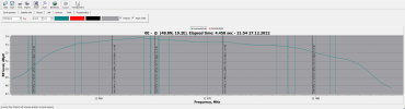

I want to be wrong, but I don't think there is a (hidden) mux between 11452 V and 11458 V.
Maybe an SDR dongle to show what IQmonitor didn't find. I tried the two modes: HR spectrum and Maximal graphical resolution. As you can see, they didn't detect an extra mux.

The only thing in the gap seen on an SDR is some kind of beacon at around 11457.1H.
I guess this is logical because until around 18 months ago there was another Towercast group frequency active, filling this gap - at 11455H with the MPE format NRJ radio stations, which was eventually turned off because of the newer 11460.5H with 'regular' MP2 radios plus the new Métropolitain DAB+ feeds.
Before the 11460.5H frequency was active, the NRJ/Nostalgie Belgique frequency was above the old 11455H at 11458H.
