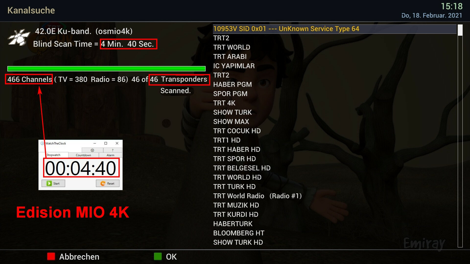

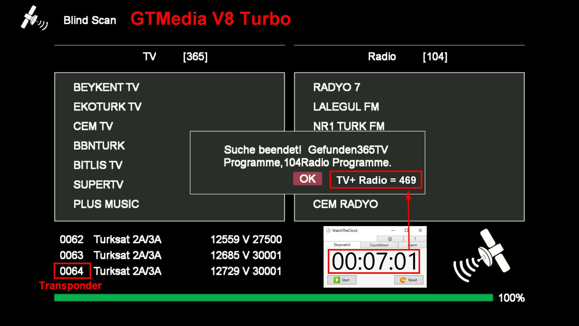

here is the result in picture of a blindscan on Türksat 42 ° East
two E2 receivers Edision MIO4K and Hitube Combo 4K
and a receiver which is not E2 the GTMedia V8 Turbo
It must be taken into account that the receivers during the blindscan
can find carrier frequencies or frequencies with data.
the V8 Turbo is not UHD and UHD programs are counted as radios.
The number of programs found should be put into perspective because some so-called programs cannot be used (image 4)
the GTMedia V8 turbo is able to find frequencies below the linc margin, but obviously cannot find the programs
