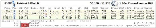

These three (four) frequencies with very small sr are very close to each other.
I don't think a receiver would be able to lock on to each of them.
I don't know about professionals, but for me
It's the TBS 6983 card + the IQmonitor program.
No problem for Octagon SF8008 (Si2166D). Just not getting 12.621 with SR144 (Tendance Ouest), not even with TBS6925.

So why scepticism in your previous post?!:confused :)
Well, thinking to professional boxes because if such radio signals are distributed on satellite someone will downlink them presumably using a professional decoder. So it would be interesting to understand which one can reach such low symbol rates.
