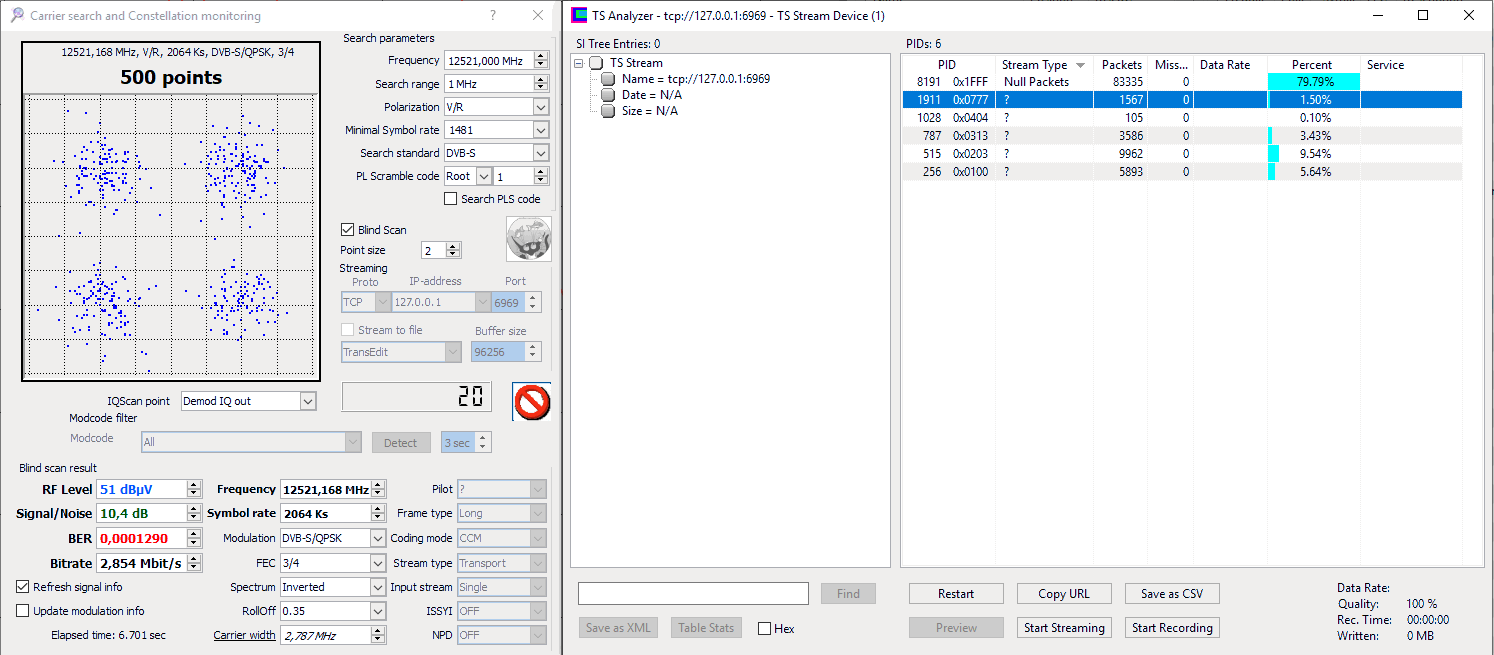

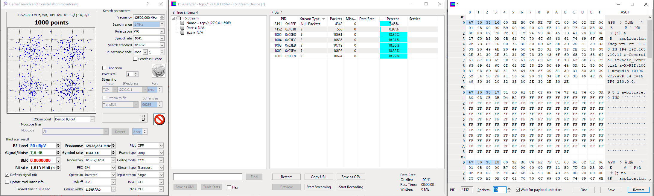

Thank you, I trust they are DVB-S from the FEC.
It has started raining relatively heavily in the past 30 mins so this might be the best I get.
12519 V 1481 3/4
100cm Hispasat fina ok,
Radio ANT1 MADEIRA
Radio ANT3 MADEIRA
12518H-DVB-IP
12518V-Radio
12520H-DVB-IP
12521V-Data
12529V-DVB-IP
